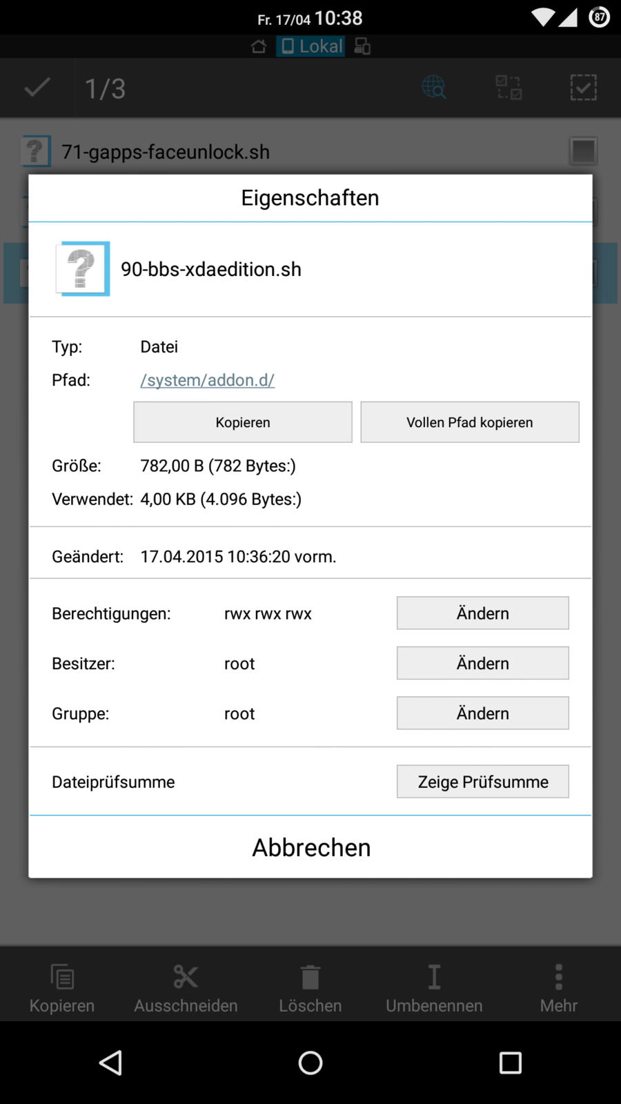

You can also apply layers with the following steps,
Also, I have added a method for people to apply Layers more easily than the application (in my opinion).
1. View your preferred page and find a theme/layer that you like.
https://plus.google.com/communities/...0-869bc7870274
HERE
2. Extract the .zip
3. Inside the .zip you will find a variety of .apks
4. Copy all of the apks using a file manager of your choice (the file manager needs to be root compatible)
5. Paste all of the apks into /system/vendor/overlay/
6. Verify that the apks have the permission rw-rw-rw (if you use Root Explorer you do not have to check permissions as Root Explorer does it for you)
7. Reboot.
