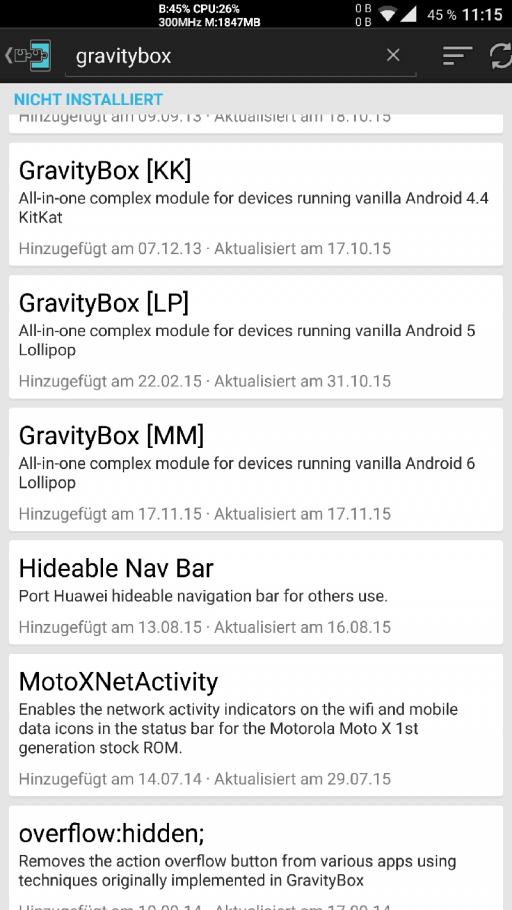

Die erste Beta für MM ist raus:
ZitatAlles anzeigenWhat's missing in version for Marshmallow compared to Lollipop
- No NFC tile. Requires further investigation.
- No LockScreen tile. Requires further investigation.
- No Music tile.
- RingerMode tile has been changed to allow only ringer specific modes: sound/vibrate/sound&vibrate. It won't allow changing Do not disturb modes, but it's still capable of indicating current DND mode. Use stock tile for managing Do not disturb modes.
- Heads up features are limited since it is no longer a standalone system window but rather standard notification which can show in special mode where notification panel is invisible
- No status bar notification ticker features as support for ticker has been completely dropped in Marshmallow.
Full commit history can be found in project's github.
- No unlinking of ringer/notification volumesQuickSettings management and SystemUI tuner
Avoid using SystemUI tuner for quick settings when you have QS management enabled in GravityBox.
SystemUI tuner QS management will crash as it doesn't know about tiles coming from GB.
Nothing to be fixed form GB side.Known issues
- UNC ActiveScreen doesn't work properly cutting off notification sounds
- Search key in the Pie controls crashes SystemUISettings from Lollipop
It is possible to restore backup of the settings made in LP version of GravityBox.Full history of changes for transition from LP to MM
https://github.com/GravityBox/Gravit...lp...v6.0.0_mm] -
