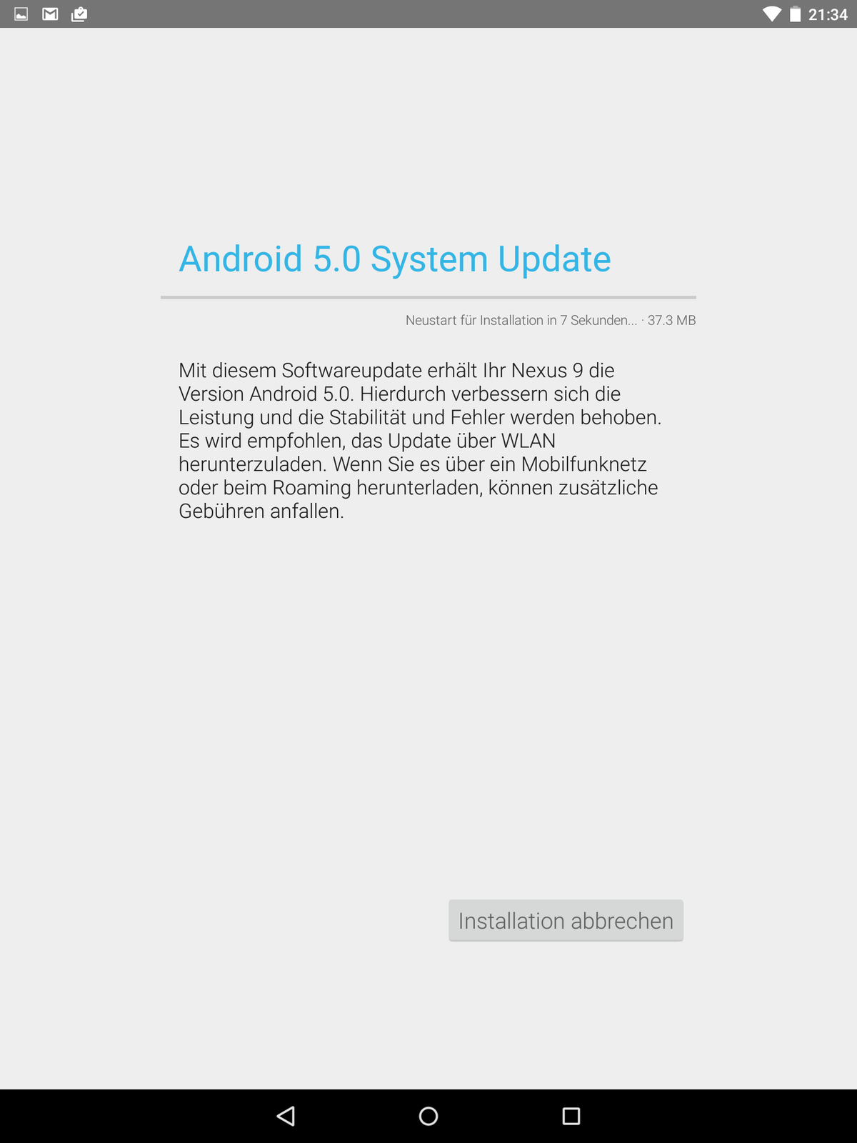

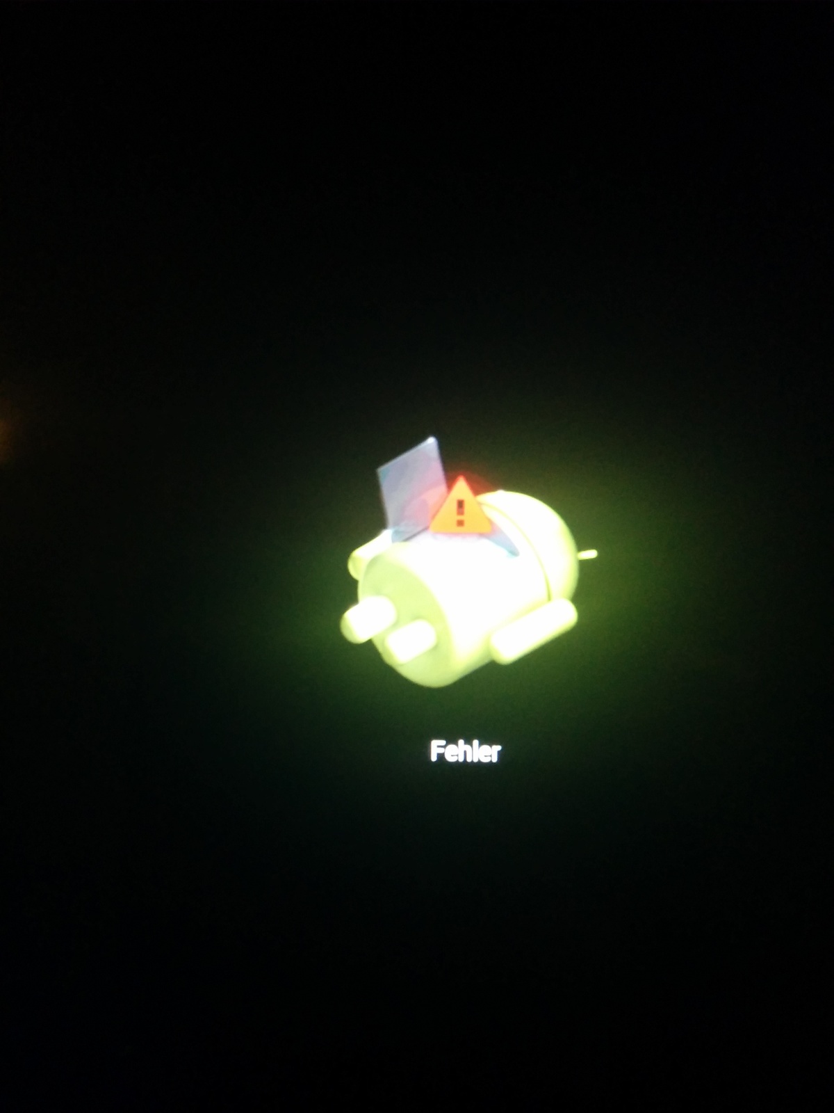

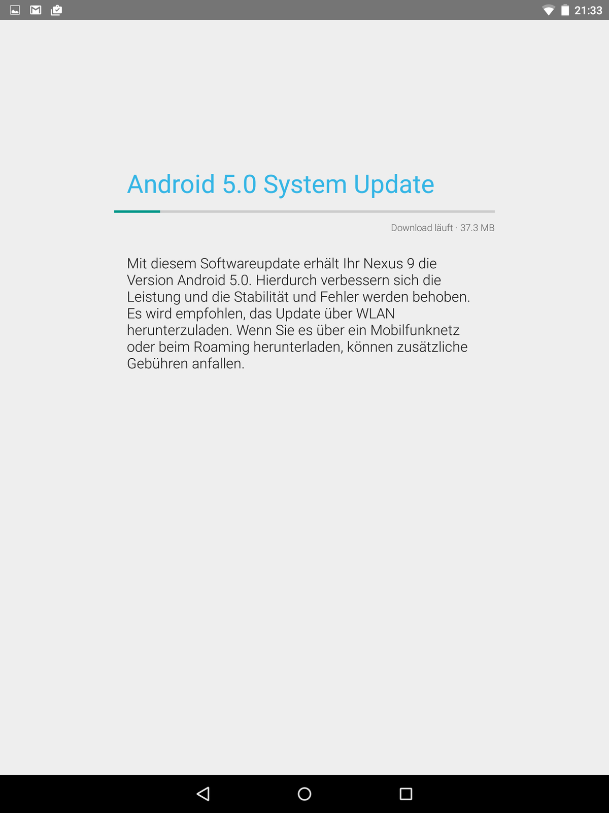

    Habe eben eine Update Meldung auf dem N9 erhalten ... alles soweit jut. OTA runtergeladen und Flashvorgang beginnt. Ende vom Lied ... der kleine Süße ERROR DROID war zu sehen.
    Hier meine Screens:
    Habe auch bei g+ gelesen das diverse andere das Problem auch hatten...
    UPDATE:
    Apparently *some* devices didn't get the recovery updated with the last update (LRX21L).
    The new update (LRX21Q) requires the newer version of the recovery to install.
    Google really messed up the launch of the Nexus 9 with all the HW/SW quality control issues
    Serious f#ck-up from Google really
    Nexus 9 get the LRX21Q update as OTA with a Changelog (sort of)
    Edit: and that's a #fail
    The tablet reboots in recovery that only display "Error !"
    bootloader unlocked, non-rooted original firmware.

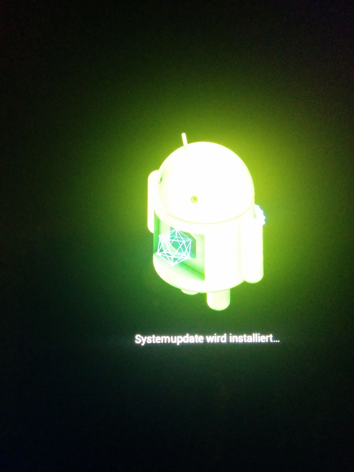

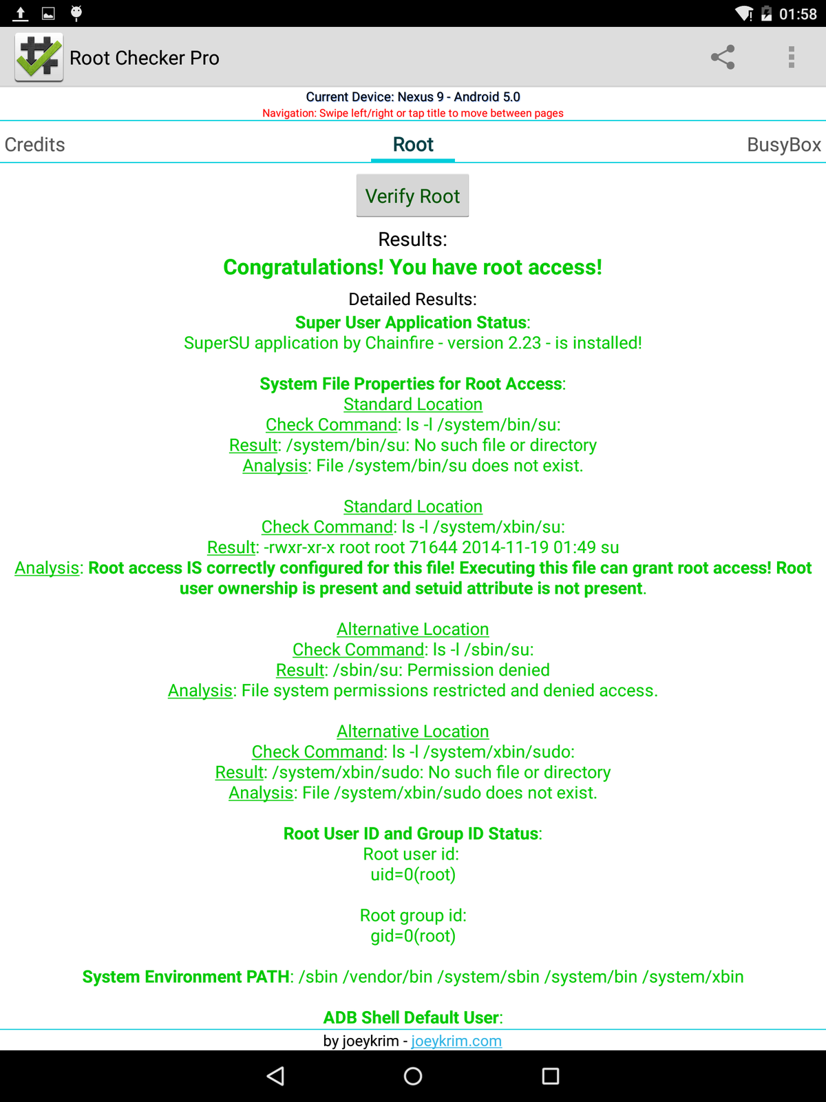

  • Vorläufige Lösung:
    [COLOR=#ff0000]
    Download the factory image, flash recovery, boot, system & vendor.
    Your software will be updated and you won't lose any data. You will lose root however.
    [/COLOR]
    [COLOR=#000000]edit: Update per Hand hat wunderbar geklappt. [/COLOR]

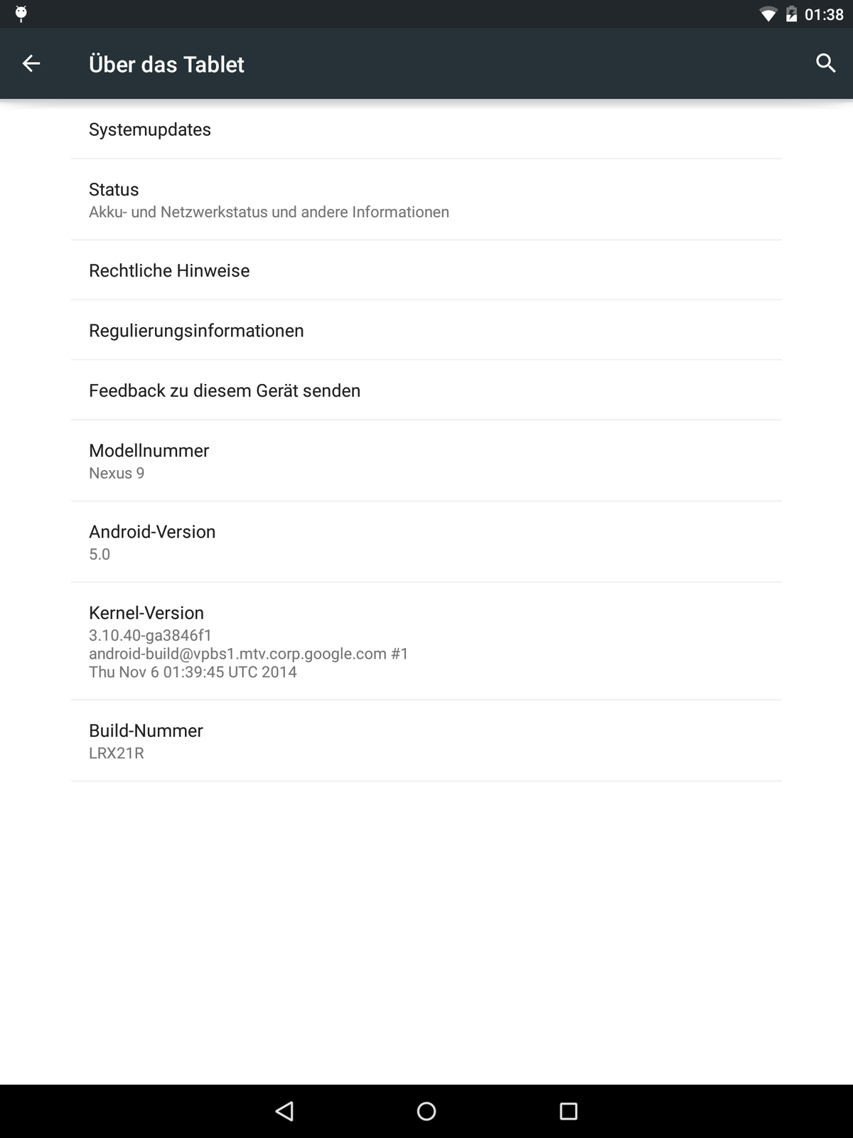

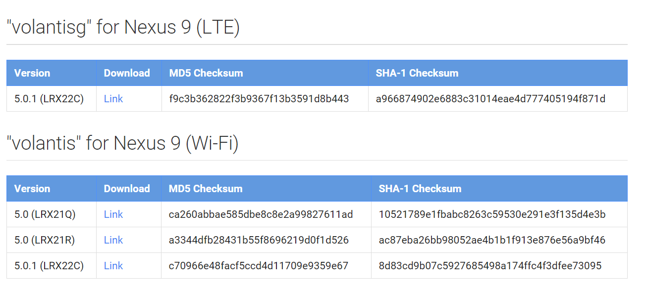

  • Sooooo... Google versucht seinen FAIL auszubügeln! :X3:
    [size=18]Google Posts Updated LRX21R Factory Image For Nexus 9[/SIZE]
    LRX21R started going out as an OTA for Nexus 9 users on the LRX21Q build yesterday, but today Google has posted the complete factory image. You can get it here.
    Hopefully this new R build will upgrade users currently stuck on LRX21L (the OTA to Q simply fails), though we don't know that for certain, as it's currently only rolling out in OTA form for those on the Q build. Other bug fixes and changes could be in here, too, though, like the odd issue with the Nexus 9's OK Google Everywhere not, you know, working.
    The Q build brought significant performance improvements and stability fixes to the Nexus 9, in our experience, so if you haven't flashed Q yet and are still stuck on L, I'd definitely recommend giving R a whirl.
    Google Developers

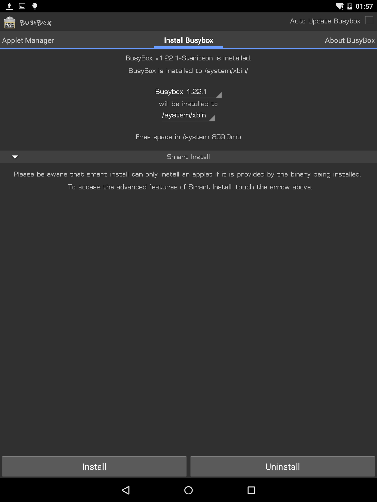

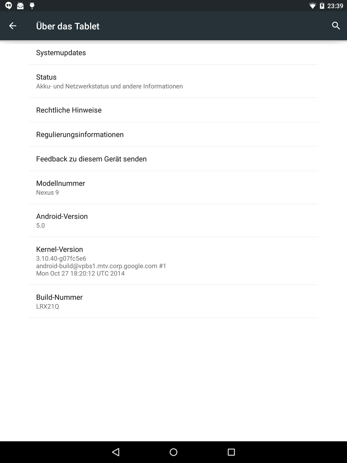

    [COLOR=#000000]EDIT:[/COLOR]
    [COLOR=#ff0000]Und nicht erschrecken beim/nachm Update ;) Immer brain.exe einschalten!
    [/COLOR]
    [COLOR=#000000]Und wenn ihr alles richtig gemacht habt - sollte es so aussehen ...[/COLOR]
    [COLOR=#ff0000]
    [/COLOR]

  • [COLOR=#ff0000]OTA Online! ;)[/COLOR]
    If your Nexus 9 is stuck on LRX21L because the "Q" OTA failed, you're in luck. There's a new LRX21L > LRX21R OTA update that actually works. Gogogogogogo!
    [size=18]Nexus 9 Issues[/SIZE]
    Update: For those of you who had issues with applying the LRX21L > LRX21Q update, that was a screw up on Google's part. Download the LRX21L > LRX21R update below and you're good to go.
    [size=14]Nexus 9[/SIZE]
    5.0 (LRX21L) -> 5.0 (LRX21R): volantis LRX21R from LRX21L
    5.0 (LRX21Q) -> 5.0 (LRX21R): volantis LRX21R from LRX21Q

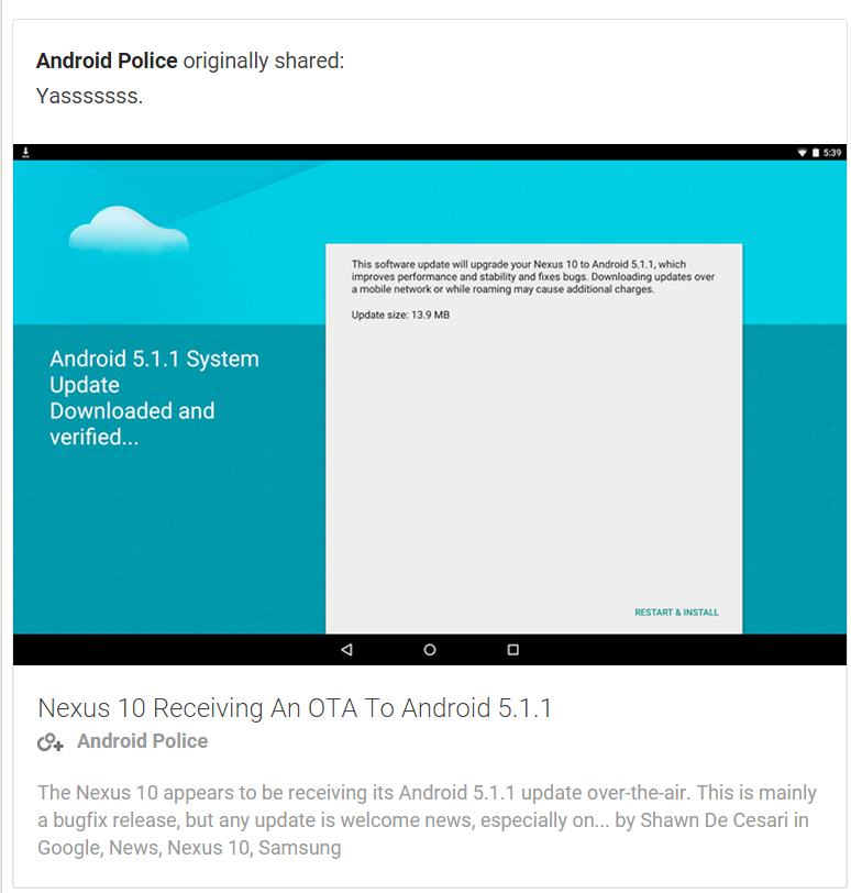

    Sascha Prüter
    +Brett Jackson I don't know the timeline (because I'm not directly working on the N9) so saying anything would be speculative and not helpful at all. The team is battling with some last minute bugs and once these are addressed we will roll the update out as fast as possible.
    https://plus.google.com/+RandyMagruder/posts/EyMiVoNNPLS
    [size=18]Android Engineering Program Manager Says Nexus 9 5.1 OTAs "Aren't Far Out"[/SIZE]
    Samsung and T-Mobile are starting to roll Android 5.1.1 out to the Galaxy S6 Edge, which is crazy when you consider the Nexus 9 is still sitting there on 5.0.1. According to engineering program manager Sascha Prüter, the OTA will be ready soon. For real this time.
    Edit?! >> Oder so inne art!
    Ich bleib dabei (N9 FTW)... egal wie es aussieht ... MEME FTW #BlameWhoever :moustach:
