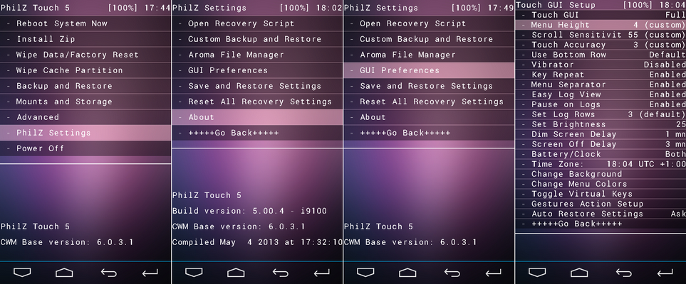

Philz Recovery Update 5.03.0
Below is full change log
In short:
- potential serious bug for /data/media devices
- Advanced Backup statistics during nandroid tar operations
- Update to cwm 6.0.3.2
- 3 new colors as requested
- Add toggles to change color of header text and battery/clock display color
- Small GUI changes (fix color highlight of virtual buttons and the bottom menu line color
Philz Recovery Update 5.03.7
- merge cm-10.1 changes: add getprop
- HTC One (m7) support
- i9505 fix graphics, date and cache/wipe issues (Big thanks to Chenglu for that)
- Samsung Nexus S (crespo) and Nexus S 4G (crespo4g) supportChancenlos 5.03.7
Dev-Host - philz_touch_5.03.7-mako.zip - The Ultimate Free File Hosting / File Sharing Service
Philz Recovery Update 5.05.0
Most changes are in nandroid backup operations and external storage mounting
Please test this and report any bugs with a log
To get a log:
ZitatAlles anzeigen
- Advanced / Report Error
- Attach here the /sdcard/clockworkmod/philz_recovery.log fileIf phone is hanguing and cannot export a log because sdcard is not being mounted:
- adb pull /tmp/recovery.log
- attach the recovery.log fileAt worst:
- Reboot into main system, not recovery (adb reboot can achieve it when needed too)
- Grab /cache/recovery files (last_log, last_install)

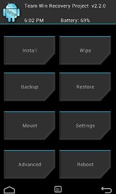

TWRP 2.6.1.0 online
Link kommt morgen. Bitte jetzt selbst auf der Homepage suchen.
Alles up2date!
Ist sogar schon 2.6.2.0 für unser Mako raus :cool:
Sent from my LG E960 Nexus 4 using Tapatalk
Sogar schon 2.6.3.0 ![]()
Ja, geht momentan schnell mit den Updates bei TWRP ![]()
Alle Recoveries auf neueste Version aktualisiert.
TWRP 2.7.0.0
Zip für die Recovery
http://d-h.st/lsl
TWRP 2.7.1.0
smartdroid
CHANGELOG for 2.8.0.0:
-Add MTP support to recovery thanks mostly to bigbiff with a little help from Dees_Troy
-Add command line capabilities - you can now execute various TWRP features via adb instead of the touchscreen
-Add support for color in the console and give error, warning, and highlight lines different colors
-Track backup and restore progress based on file sizes to provide a much more accurate indication of progress
-Improve handling of /misc thanks to mdmower
-Improve setting of time on Qualcomm devices thanks to [NUT]
-Allow using images on slidervalue GUI objects thanks to Tassadar
-Allow using variables and addition and subtraction in variables for easier theming
-Add support for 1440x2560, 280x280, and 320x320 resolutions and update 240x240
-Allow ui.xml file to include additional xml files to help break up the theme and make TWRP easier to maintain
-Other minor fixes and improvements
Over the course of the last year or so, bigbiff has worked to migrate various Java functions from Android's MTP implementation to bring you a fully C++ based MTP implementation that allows you to transfer files to both emulated storage and Micro SD cards. It's confirmed to work on various Nexus devices but we may have to make some changes on other devices to keep Windows happy. Windows is very picky about USB IDs and its drivers. We have tested it on Windows 7 and 8 as well as Ubuntu 14.04 Trusty. MTP is enabled by default, but we do toggle it off and on automatically during certain operations such as if you choose to wipe a storage partition. You can enable or disable MTP under the mount menu in TWRP. For more about what MTP is here.
Note: Due to a weird bug with our MTP setup, you cannot copy a zip file to the root of storage with Windows. You can change the .zip to something else like .txt and then copy it to the root and rename the file back to .zip once it's copied to the device. You can also copy the zip into any subfolder.
Command line support is also now available. You can perform various OpenRecoveryScript commands via the adb shell. Depending on what you are doing you may wish to do a "twrp set tw_mtp_enabled 0" and then reboot to prevent the MTP auto toggle from killing your adb interface. You can use this option to create and restore backups, wipe, install zips, and more. Via adb shell, type twrp followed by a space then enter the OpenRecoveryScript command and hit enter. [DLMURL="http://www.teamw.in/OpenRecoveryScript"]Find more OpenRecoveryScript commands here[/DLMURL].
Download:
http://j.mp/n4twrp für Installation über TWRP
http://j.mp/n4cwm für Installation über CWM Touch und Normal
CHANGELOG for 2.8.0.1:
-Fix a bug that causes weird graphics glitches and touch issues
