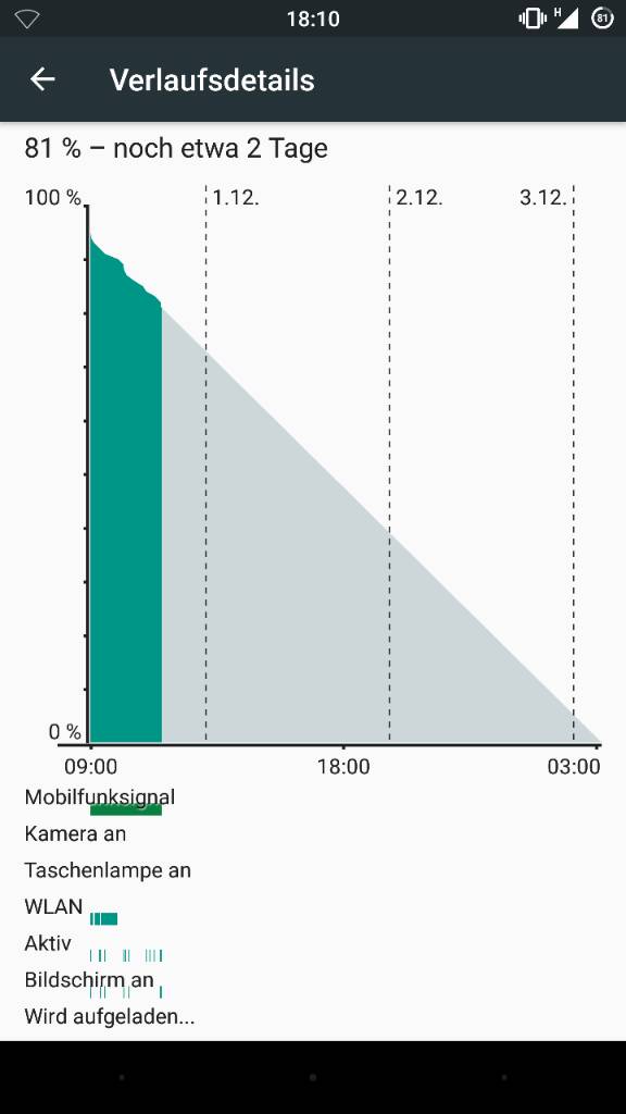

    aus dem Xperia Z3 extrahiert , es "scheint" zu funktionieren und was zu bringen , im XDA Forum wird jedenfalls davon berichtet
    After half a day I'm going to have to say I'm convinced. I usually only make it to 3.5-4 hours of sot and I'm over 4.25 hours and still have 30% battery left. This is encrypted on M preview 3.
