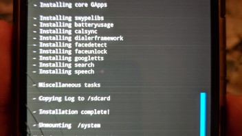

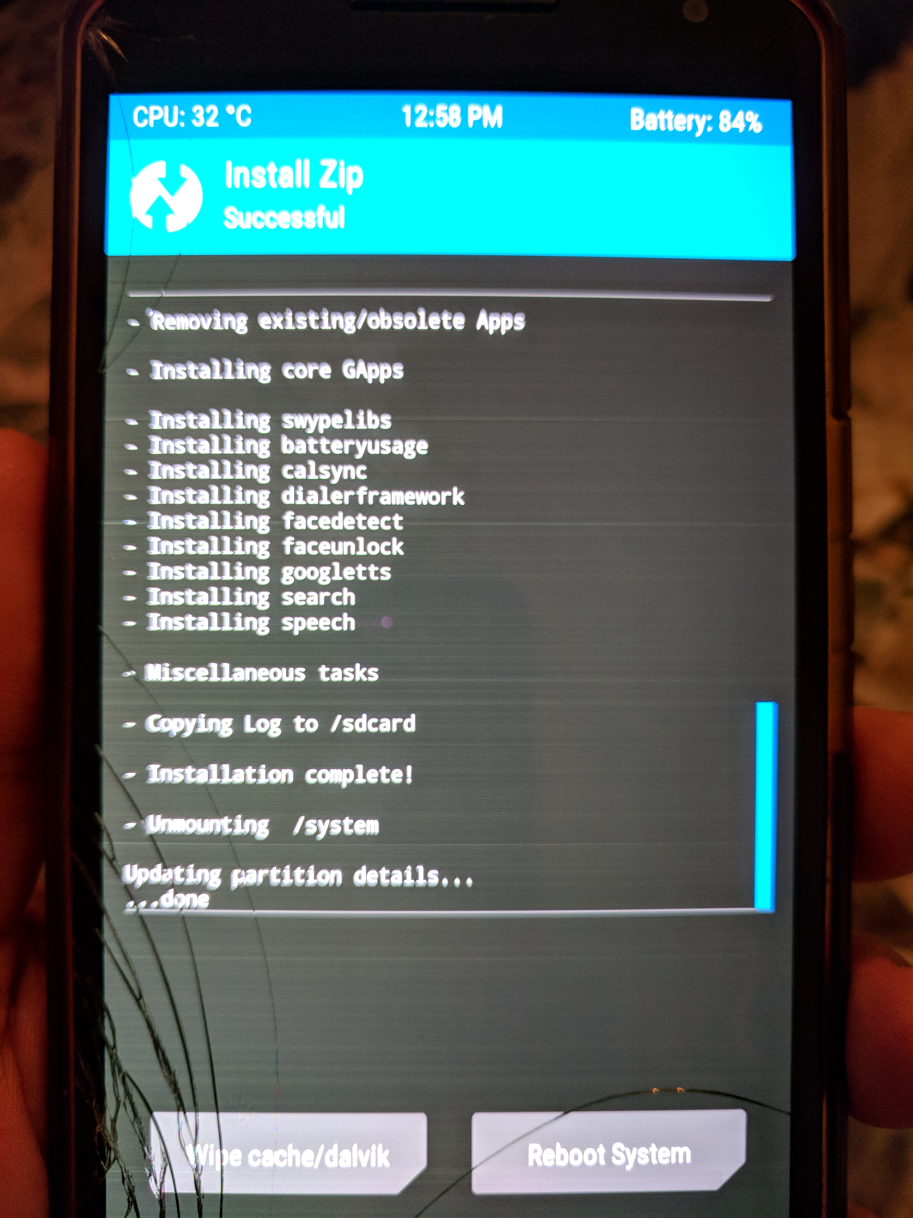

Here is a screenshot.
On your screenshot, gapps is installed fine, without a problem.Where is the problem?
The problem is that after the restart are not there?

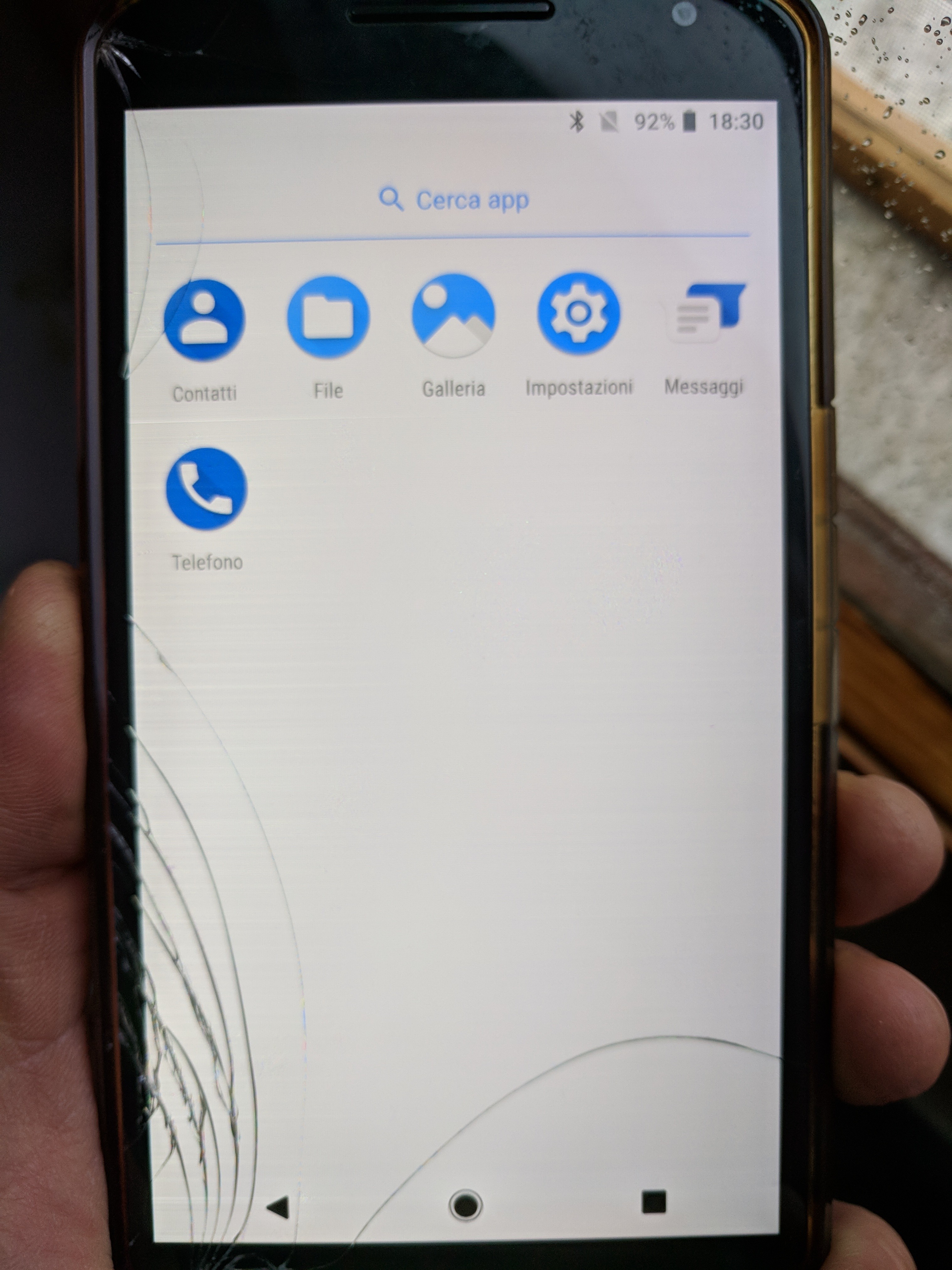

the rom yes lights up immediately and does not ask for any account, when you start there is no play store there is nothing, a rom without gapps.
